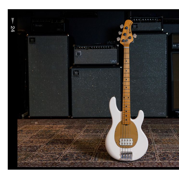

Anyone ever made or played a passive bass with no volume or tone pots, just pickup straight to jack?
JohnWainwright
- Posts: 18
- Joined: Sat Aug 28, 2021 8:49 am
Post
by JohnWainwright » Wed Sep 01, 2021 10:03 am
Shadoweclipse13 wrote: ↑Wed Sep 01, 2021 6:40 am
Well - not where that was the
only option...but I've wired them up with push/pulls to enable straight-to-jack as an option, so...same end effect.
It's a little louder/brighter than when wired through controls maxed at "10". (How much more a "little" is, depends entirely on the pots/cap in question.) Be tough to control in a performance setting with other instruments. Maybe run it through a volume pedal - or whomever is running the board is gonna be busy.
But yeah...it works.
jw

Good to know! I don't think I'd want a bass with no controls at all, but my Jag bass has a MM humbucker, and I'm tempted to put an active volume and tone circuit in it. The issue there is that I'd have an extra 2-position Jag switch (upper rhythm switch essentially) that I wouldn't have anything to use it for. I was thinking a volume and tone bypass if I want to switch from active back to passive, but i don't want any more pots/knobs/holes in the pickguard.
I was tempted to make it a phase switch, but I'm not sure that a MM humbucker with half of it out of phase with the other half is a sound I'd care about. I'll try it all out (breadboard!) before deciding.
Thanks for the quick response!!

Joe Dart does, and he seems to be doing fine! I bet you will too.
Never heard of him. Thanks for the information, I'll have to look him up! And that bass is gorgeous!!!
