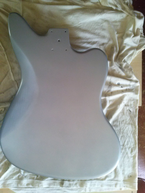

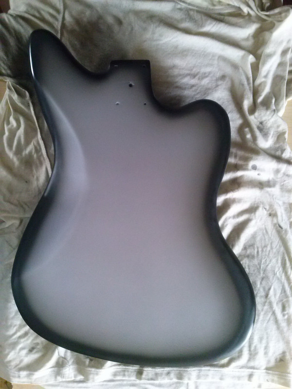

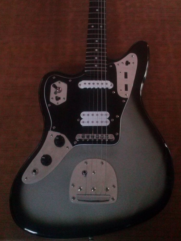

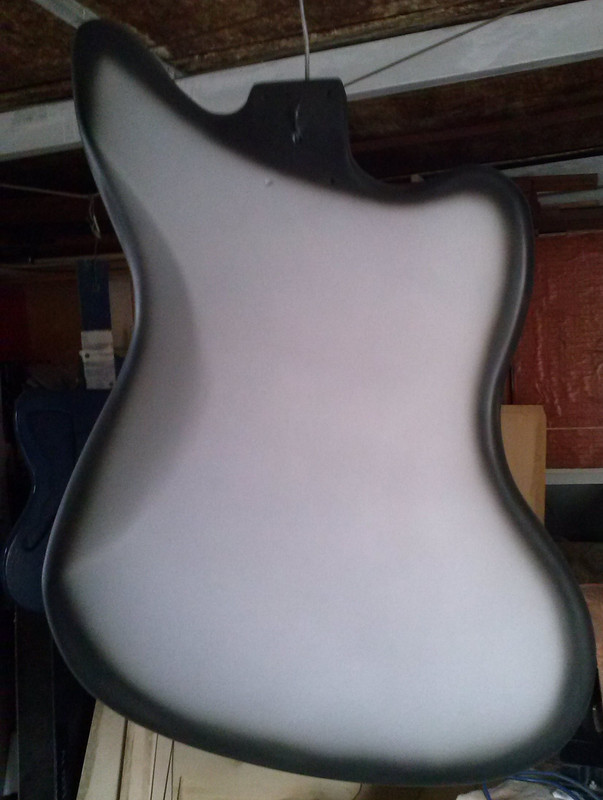

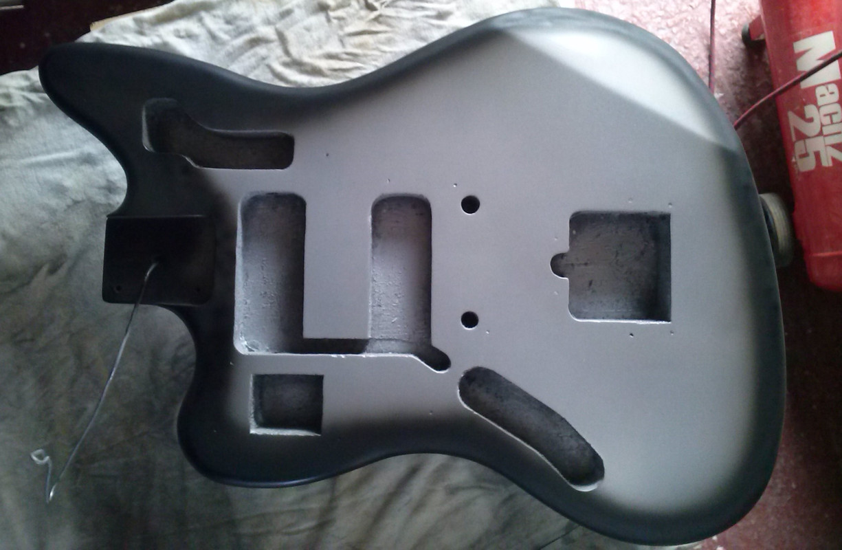

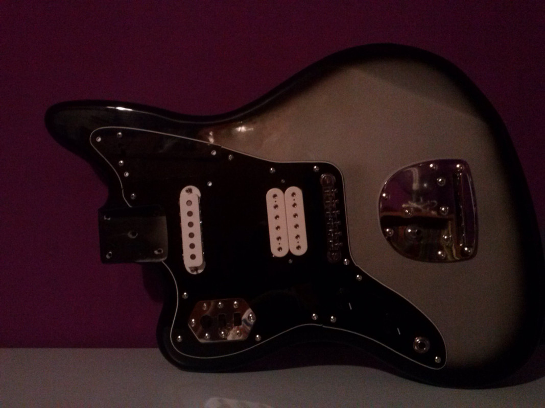

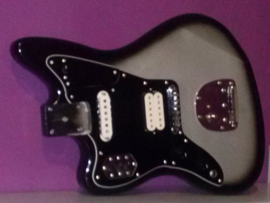

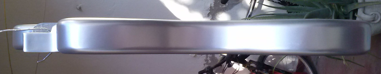

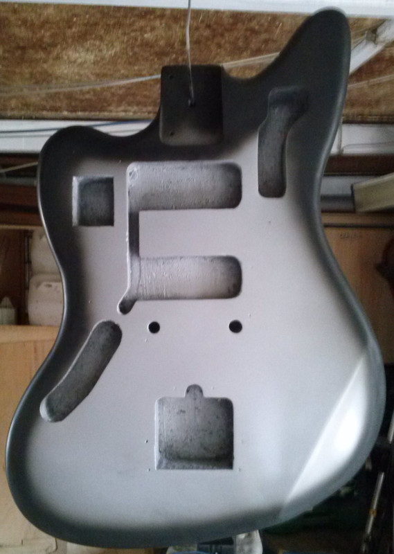

I'm a not-expert who has done only one burst so far and this is my only experience with the airbrush.
Here's what I did back in 2013 with my scratch built Silverburst Jaguar:
1) Prepped the body with sealer and primer.
2) Acrylic rattle cans metallic silver base coat followed by acrylic clear lacquer to seal & protect the colour:
3) Air brushed the black nitro burst with very thin passes along the outline, basically dusty and opaque looking:
4) There was some tiny level of dusty overspray in the central area, but the clear coat between the silver and the burst allowed a clean sanding job without any damage to the metallic finish, so it was just a matter of a last air-brushed black band along the outline to feather the burst evenly.
5) Ultimately, with a spray gun & compressor I went on sealing everything with several thin coats of nitro clear. Then let dry for a while, sanded, polished and buffed:
It's not perfect by any means and pictures don't do justice to the final outcome as it is way more glossy and depth looking in person but, I promise you, it was much better than I was remotely expecting as a total beginner.
The air-brush is a much forgiving tool than both spray-cans and spray-gun.
Just practice a bit on scrap to get a grasp on how to handle the spraying process (angles, distance, fan etc..) and you'll be growing enough confidence to take a full stab at the real deal.
Worst scenario, as long as you've put the clear coat to protect the base colour, you'll just have to sand the burst off and start over without much set-back.
I hope it helps

Here's my 1st attempt at 3-tone burst with spray paint. I'd been wanting to repaint my oldest and dearest partsmaster from 2009 for a while, just could not decide on a color. So when I found the Molotow Transparent sprays I thought I'd give it a go, and worst case scenario would be to then paint over it with a solid custom color. Was going for a 70's style with a very thin black band, I think it worked out better on the back... I managed to somehow melt the red and black in the front, but after already sanding it off a couple a times I gave up...
Stained the body with an amber tint I had, light clear coat, red and then black. It would need more clear and a proper buffing but I didn't have the patience for it.
Could probably do a better job, but for a 1st I was pretty happy with it. Now of course I'm feeling like doing it again
Having all that leftover paint I then made a JM body to have a holiday project, this time I wanted to go for a 59-style burst. 1st pic is before sanding and polishing. Again, not perfect, but I was more pleased with how this one turned out.
