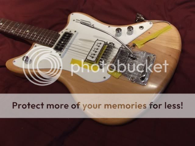

This is all I have so far, a Kay pickup crudely mocked up on my Jansen Jazzman. Sounds great, but not tunable of course. I've tried running the BTB pickup through it's own effects (just delays so far). Endless possibilities! 8)
