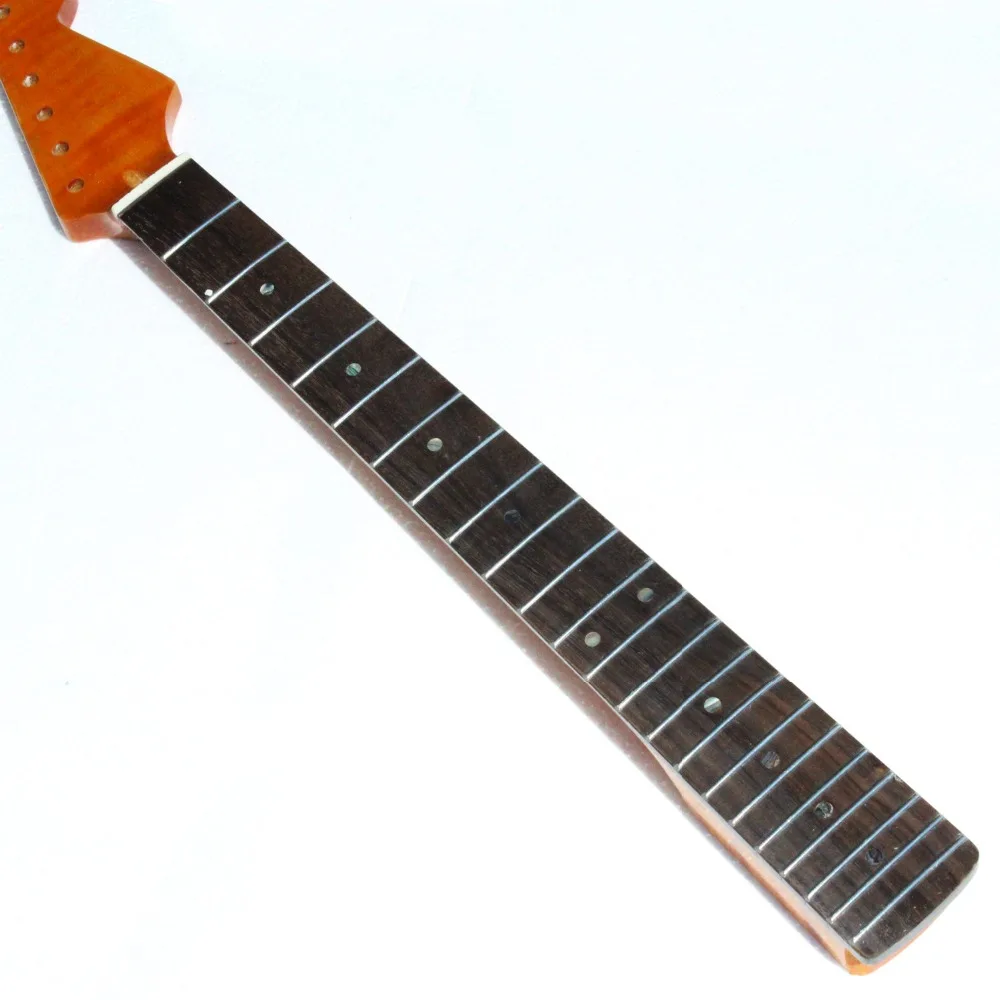

I contacted the seller, and asked him to change the neck for the kit with another neck he has for sale:
https://www.aliexpress.com/item/3302597 ... 3bc2drJuQ7
Why did I do this, you might ask?
A lot of (cheap) guitar kits have bad necks.
Sharp frets, not leveled, cheap dry wood and they don't look as good.
I ordered multiple times from this seller and they make high quality guitar necks,
with amazing fretwork, good quality and good looking wood and they make it custom for you.
It is a 25.5'' flame maple neck with a rosewood fretboard, 22 frets, bone nut, pearl dots and bottom truss rod adjustment (not in the picture, but the listing was for a vintage truss rod adjustment).
