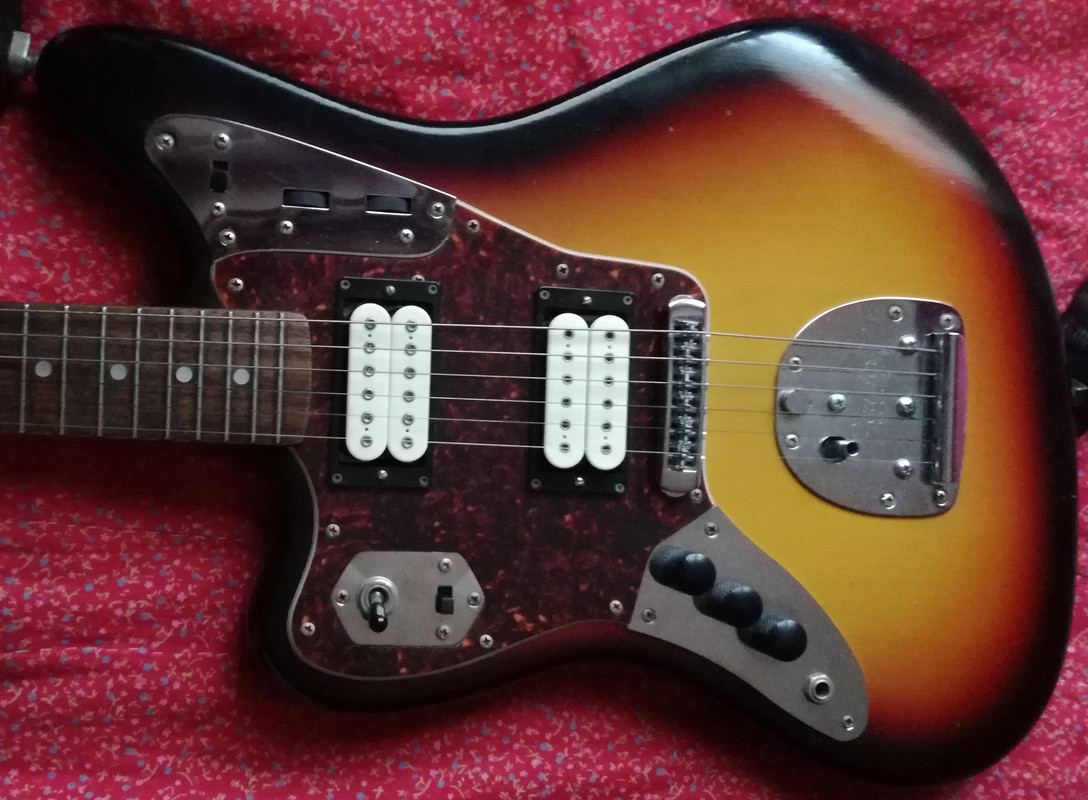

Recently decided to break the bank and got a Classic Player Jaguar special HH and it's amazing but it's missing something.
I put a super distortion in the bridge because the enforcer bridge pickup was a bit too damp and now it sounds brilliant in the bridge and middle position
But what would you do to it to make it better?

Welcome on board and congratulation for your new axe :D
I don't know what modification would suit the word "better" by your parameters but... A good set-up is where to start if you can't define what else you need the urge to modify, right?
P.S.:
Can you post pics of yer Jag for us to get an idea on the possible improvements? :ph34r:

_meisterman_
Posts: 8
Joined: Sun Mar 31, 2019 4:41 am
Re: What mods would you do to a Jaguar HH?
Post by _meisterman_ » Fri May 17, 2019 1:05 pm
of course! wouldn't be much of a guitar board without many guitars would it?
