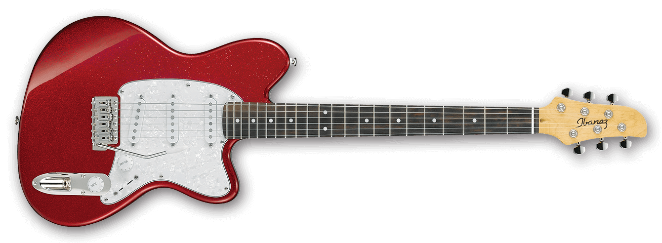

Being an offset, they do feel different from either a strat or tele. The shape is a bit of a Tele/Jazzmaster mix, while they feel and play like a Strat built with a Mustang body. It's worth noting that anyone who can't get past the location of the volume knob on strats, won't like a Talman. The newer reissue models will be easier for modding, since there is less proprietary hardware, and I feel that the overall quality is higher in these.
If anybody is on the fence, look at the TM330P.
-Alder body with red sparkle finish
-Locking tuners & bone nut
-Straight pull headstock without a string tree
-Fretboard is bound in matching wood
-Great upper fret access
-Easy availability of custom pickguards these days
-Can easily be found for under $400
