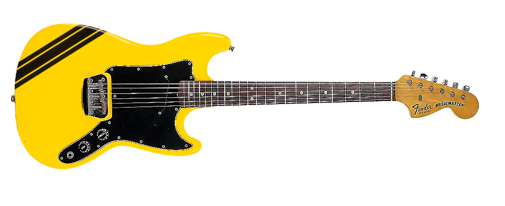

I think this may be my favorite ― Graffiti yellow with black compstripes, just like that FSR Bullet Mustang. For some reason I think this color combo looks very punk... maybe because of Olga's Tele?
